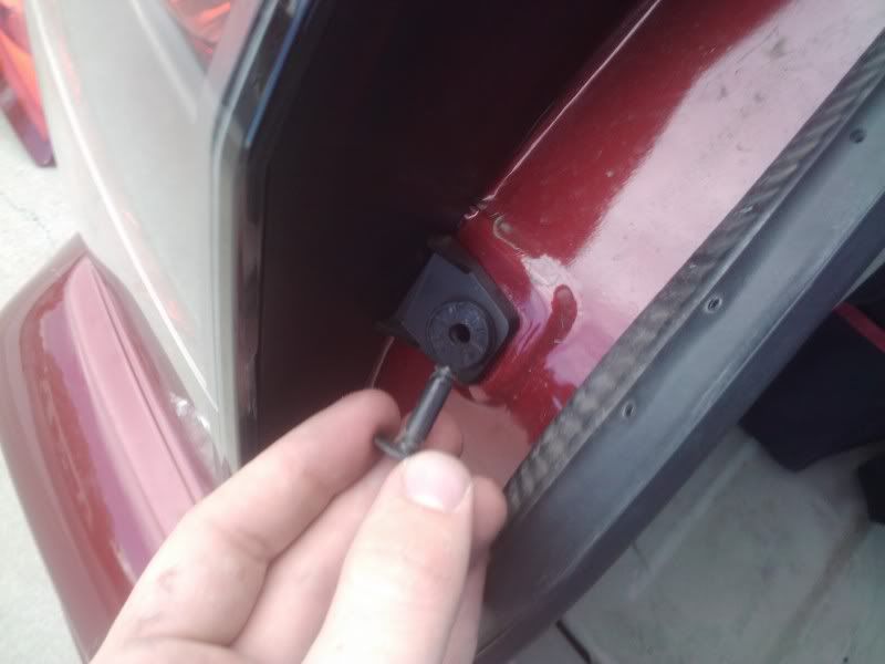

first pry out this clip with a flat head.
then pull out the second piece.
Do the same for the bottom.
Gentely pull on the tailight untill it pops out, its held on by 2 ball sockets
Twist to unlock the stock bulbs and pull them out.
replace the bulbs in the new unit.
replace the tailight. and repeat for other side. it took 10 mins to do them both.
