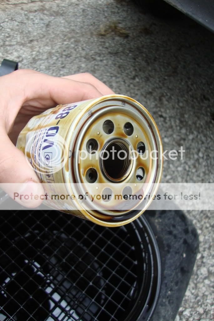

Now we will remove the oil filter. If you cannot remove the oil filter by hand use a filter wrench but be careful because some oil will leak out and may be hot. Pour the remaining oil out of the filter into your drop pan.

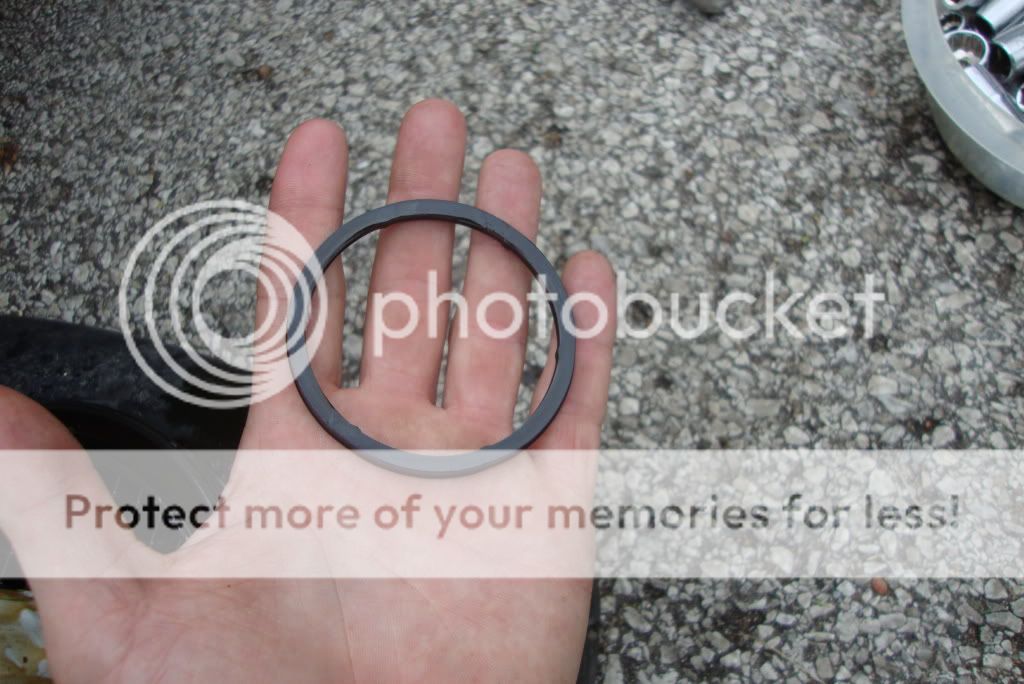

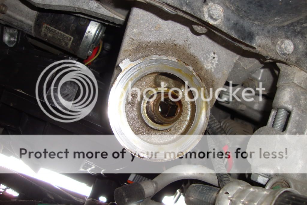

Now inspect where your filter was clean it of any old oil and debris. Make sure the rubber ring from the old filter is not stuck.
My rubber ring was stuck but I removed it before thinking about taking a picture so this is the ring I am talking about and the old filter.
As soon as everything is cleaned up grab the new filter and prime it. To prime the new filter pour some new oil into it with your finger spread the oil around the new rubber ring (gasket) and install.
The filter also has torque specifications but I put it on hand tight.

Nice write up, should help out anyone who hasn't changed their own oil before. Good you mentioned about the gasket, that has happened to some people I know, that could cause some serious problems.
