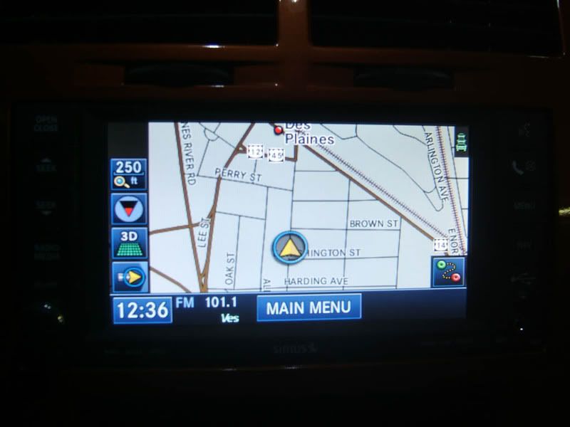

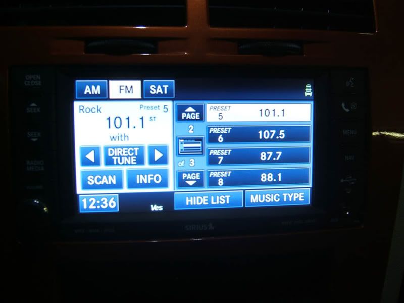

Well with inspiration and some help from GeeEssFore I decided to install a RER MyGig also. It's a really simple install as everything is plug and play. The only thing that I don't have working yet is the Sirius satellite radio. This is because the MyGig unit has the sirius tuner built right into the unit, and you have to connect the sirius antenna directly to the rear of the MyGig. I have ordered an extension cable that I should be able to tap into the existing sirius antenna and run it to the MyGig. The cable is scheduled to be delivered tomorrow and I'll post some pics of the install process. For now, here is what it looks like:
